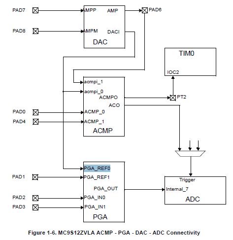

Here what is meant by External PGA_REF0 and PGA_REF1?

About  External PGA_REF0 and PGA_REF1)
I hope it helps you.
