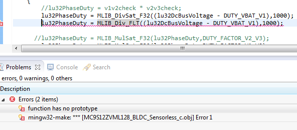

I want to perform Multiplication and Division operation on floating type variables, but getting below error.

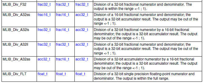

Below library functions give output in range -1 to 1 which is not of use.
Trying with MLIB_Div_FLT library but getting error, function prototype not present.

The standard MTRCKTSBNZVM128 code works with fractional numbers.
The S12Z do not have hardware support for floating point calculations and software emulation presents too big overhead – the multiplication and division operation of float variables will take hundreds/thousands of bus cycles.
Therefore the MLIB_Div_FLT() function is not implemented for MCUs without floating point hardware.

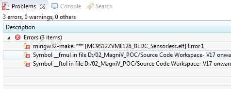

Of course, you may still multiply/divide floating variables by software emulation. In that case, you may simply use appropriate ANSI library (e.g. ansif.lib) and use standard “*” or “/” operands.

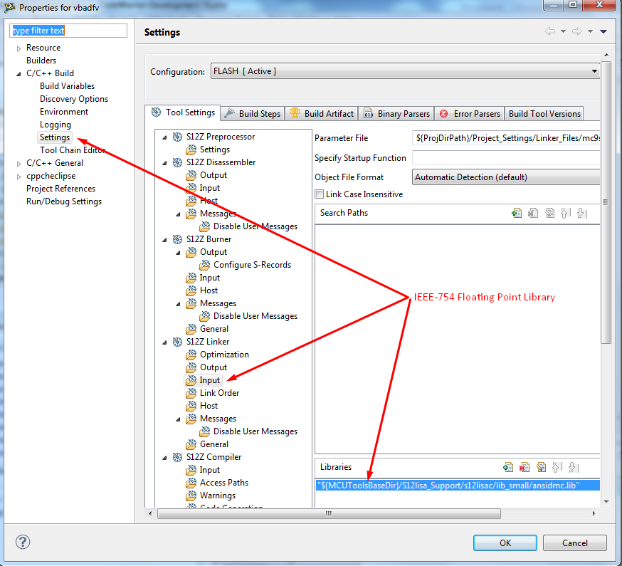

1. Float is IEEE32, Double is IEEE32 optimized, Long Long is 32-bit
ANSI library: ansif.lib
Compiler options:
2. Float is IEEE32, Double is IEEE32 compliant, Long Long is 32-bit
ANSI library: ansifc.lib
Compiler options: -fp_compliant
3. Float is IEEE32, Double is IEEE64 optimized, Long Long is 64-bit
ANSI library: ansidm.lib
Compiler options: -double_size=8 -bit64_code_gen mem
4. Float is IEEE32, Double is IEEE64 compliant, Long Long is 64-bit
ANSI library: ansidmc.lib
Compiler options: -fp_compliant -double_size=8 -bit64_code_gen mem
