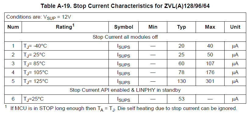

Could you check the max stop current when API enabled & LINPHY in standby?

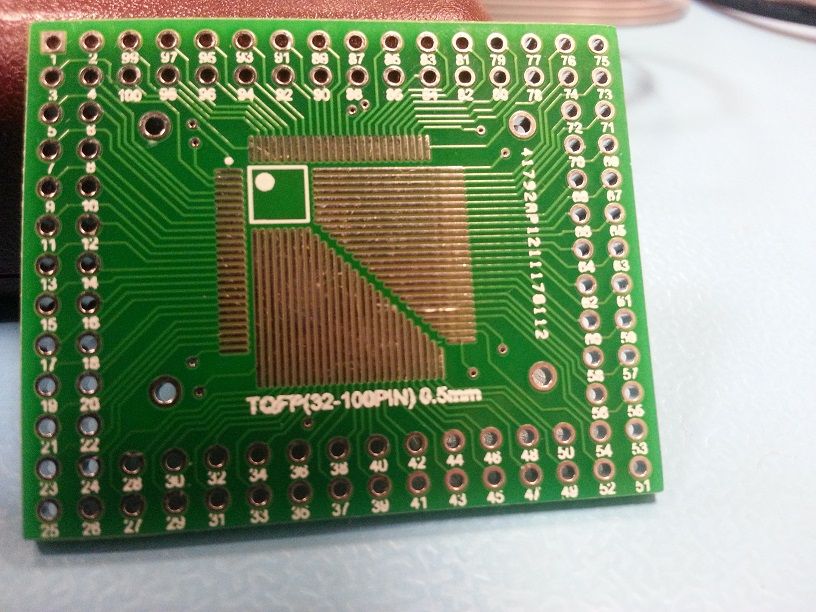

Anyway, colleague showed me this proto board:
I've ordered S12ZVL samples so i can build simple circuit and get MCU alive for testing purpose.

The appropriate way to measure the current consumption in Stop mode would be to have a proto board (with ZIF socket for example) with just main supply pins connected to the MCU.

Summarized to your comments, it is about 70mA in stop mode for DEVKIT?
Kate Lee
2,241 Views
iggi
70mA?
I hope you mean 70uA... But, still the DEVKIT board with S12ZVL more than 1mA in Stop mode and that's very rough measurement.
