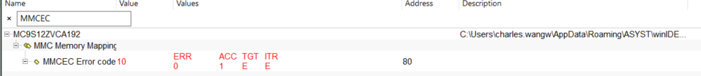

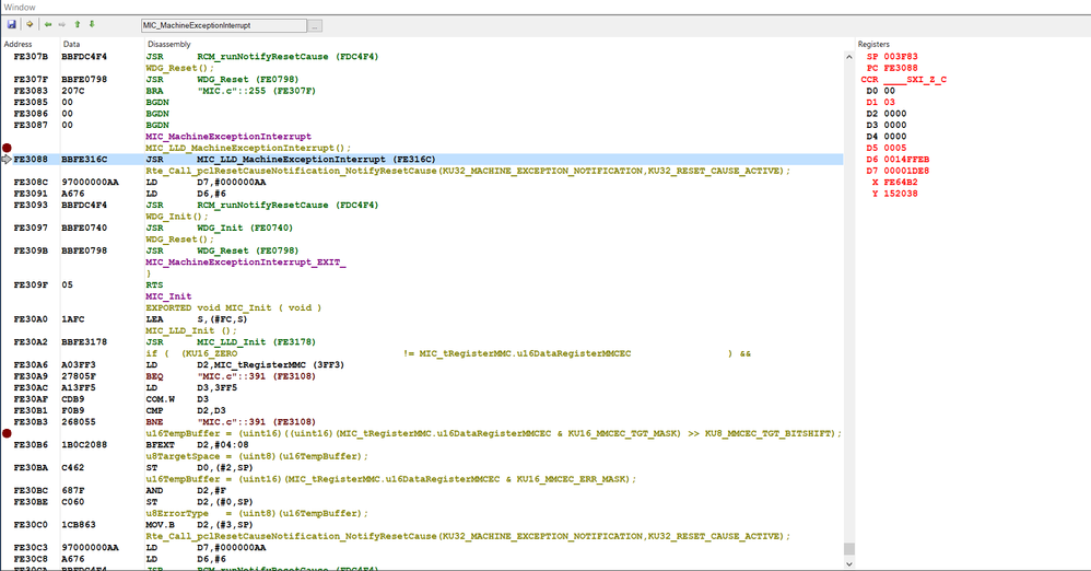

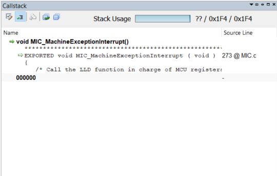

Hello
During my develop. I get an Mchine Exception . Could you please share how to catch the error code? And where I can find the root cause in my code.
Thank you very much.
Charles
1 返信
847件の閲覧回数
kef2
Senior Contributor V
what is exactly in MMCECH and MMCECL when ME happens? What is TGT=E and ITR=E, hex value 0xE? Shouldn't happen.
Edward
