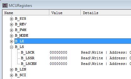

I have a stange issue for MM912H634 low-side drivers test,
Firstly, I use  B_LSCR_LS1 and  B_LSCR_LS2 to control the relay with below code and 9V voltage,
Everything is ok, the relay can work as I expected.
    B_LSCEN = 0x05;
    D2DCTL0_D2DCLKDIV1 = 1;
    D2DCTL0_D2DCLKDIV0 = 1;
    D2DCTL1 = 0x8F;
    D2DCTL0_D2DEN = 1;
    B_WDR = 0b01000111;
    B_WDSR = 0xAA;
    for(;;)
    B_LSCR_LS1 = 0;
    long_wait();
    B_LSCR_LS1 = 1;
    long_wait();
    B_LSCR_LS2 = 0;
    long_wait();
    B_LSCR_LS2 = 1;
    long_wait();
    _FEED_COP(); /* feeds the dog */
Then, during the relay is working, I artificially simulated a voltage drop(9V --> 3.6V), relay stopped.
Strange issue happened, relay stopped forever, even I re-make the code and re-flash MCU, re-Power on,
I checked the MCU LSx rigister and found no change as below even I run Step over the code.
I do not believe the haredware is destroyed.
Can you please tell me the possiable reason?
Thanks a lot!

Hi David,
I suppose that it could have something to do with bg1p25sleep trimming at analog side.
Please try following recommended initialization procedure:
#define IOBYTE(address)    (*((volatile unsigned char*) (address)))
#define IOWORD(address)    (*((volatile unsigned int*) (address)))
#define TRIM0 IOBYTE(0x80C0)
#define TRIM1 IOBYTE(0x80C1)
#define TRIM2 IOBYTE(0x80C2)
#define TRIM3 IOBYTE(0x80C3)
  D2DCTL1  = 0x8F; // IRQ enable, max timeout
  D2DCTL0  = 0x80; // D2D enable, 4Bit, !Stop in Wait, D2DCLK=BUS
  D2DSTAT0 = 0x80;  // Clear D2D Errors
  MMCCTL1 = 0x01;
  B_CTR0 = TRIM0;
  B_CTR1 = TRIM1;
  B_CTR2 = TRIM2;
  B_CTR3 = TRIM3;
  B_CTR2 = 0x1E;
  MMCCTL1 = 0x00;
  B_LSCEN = 0x05;
I hope it helps you.

RadekS
You are welcome.
If I understood correctly, it works now… Right?
Unfortunately, I am not sure if reading MCU SPEC will really help, in this case. I never thought that trimming value of internal reference could have any influence on low-side drivers. But it has. It is simply analog die and it needs set trimming values before use.
However I suppose that this issue with low-side drivers is described in errata:
http://www.freescale.com/files/analog/doc/errata/MM912_634ER.pdf
See “Unexpected setting of VROVC Bit and disabling of Low-side Driver(s) at VSUP Power On”
It seems that recommended loading values according reference manual is slightly different:
  B_CTR0 = TRIM0;
  B_CTR1 = TRIM1;
  B_CTR2 = TRIM2 & ~B_CTR2_SLPBG_LOCK_MASK;
  B_CTR2 |= B_CTR2_SLPBG_LOCK_MASK;
  B_CTR3 = TRIM3;
Errata recommend do not lock CTR2 values by lock mask as workaround
// B_CTR2 |= B_CTR2_SLPBG_LOCK_MASK;
In that case trimming values must be loaded at every MCU reset.
Note: I already met with similar issue and using template code from delivered CD helped me.
Code from my last reply is just copy-paste from this template code.
RadekS
3,221 Views
daviddai
Hello RadekS,
Yes, it works well.
Also I found the VROVC Bit is abnormal, it always is 1.
Now after adding the new code, it's ok.
Thanks a lot!
Best Regards
David Dai
