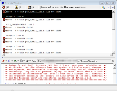

kemingkai
Hi StanoA
i can't find the file per_XDx512_L15Y.h and per_XDx512_L15Y.c,Some variable definitions cannot be understood,Do you have these two files?
3,392 Views
StanoA
Hi Kemingkai,
What kind of project are you trying to open? Please provide more information for help.
Stano.
3,361 Views
kemingkai
Hi StanoA:
     We want to make a shifter project, and if there is an SDK package for this chip, thank you in advance。

StanoA
Hi Kemingkai,
the SDK = Software Development Kit is not available for this MCU family. But you can select another MCU for SDK use on web:
https://www.nxp.com/design/software/development-software/mcuxpresso-software-and-tools-/mcuxpresso-s...
I hope it could help you to solve your task.
