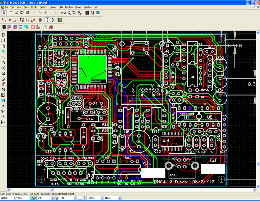

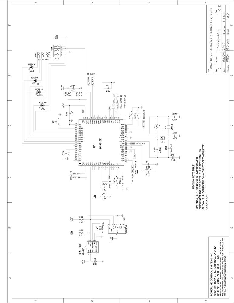

MC9S12E128CFUE will not oscillate with pierce
1) used pierce osc for 5 years on older controller pcb
2) designed new pcb with some optoisolator changes and other component changes - 2 layer
3) OCS and PLL layout unchanged
4) OCS and PLL layout unchanged exactly as specified in data sheet
5) PE7 XCLKS tied directly to VSS to select pierce osc
6) xtal is ECS 8mhz Part # ECS-80-20-4
7) 22pf caps 1.0 mohm in parallel no RS series resistor
8) tried many different xtals and caps - no success
9) tried 3 different batches of processors for DigiKey Mouser and Arrow with no success
10) checked every power supply and ground pin
11) made sure VDD1 and VDD2 are connected to only decoupling caps and nothing else
12) lifted all pins except DBUG, VDD and VSS pins and OSC and PLL pins so they are connected to NOTHING - no success
13) built new 4 layer PCB and tested as above - no success
14) I was told OSC needs NO program to run correctly and should see correct OSC on oscilloscope - nothing
15) on one pcb the OSC signal would appear around 4Vpp for 30 sec then drop to 2VPP for 30 sec then drop out entirely
16) mask sets used are all: 0M06C

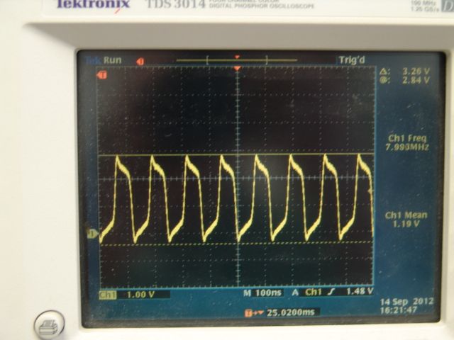

I think maybe I am burning out the osc circuit in the processor. Look at my XTAL output below. 3.2VPP and it dips below ground slightly. Definitly not a sine wave.
Also - is it OK to tie PE7 direstly to ground with no pull down resistor? It is tied DIRECTLY PERMANENTLY to VSS.

Did it start oscillating after you increased feedback resistance? What value it is? Try lowering, amplitude should fall down.
It is not best practice, but also not big problem to tie PE7 to GND directly. Just remember to not set DDRE bit 7 and PORTE bit 7 high.

We have been working on this.
We connected a new processor and this was the waveform at XTAL.
It ran for about 1 minute then went flat never to run again.
Please find out the answer to this question.
Can an overdriven oscillator somehow destroy or burnout the OCS drive circuit??????

DPB
Hello
The OSC circuit can be damaged by applying voltages above the absolute max. rating of the associated pins.
The absolute max. rating for VDDPLL,XTAL and EXTAL is 3V for this device.
The voltages quoted above (3.2.V and 4V) exceed this.
Please ensure that VDDPLL is connected to a 2.5V range supply.

We dont put any Voltage to any of these pins. VDPLL is internally connected to the processors 2.5V supply. All other pins are just connected to the XTAL and caps exactly like the Freescale data sheet.
