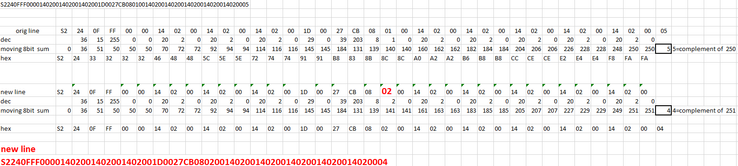

Your original code does not contain writing to security byte so after mass erase
It contains only these addresses from the range 0x0FFFxx :
S2 24 0F_FF80 C000C000C000C000C000C000C000FD29C000C000C000C000C000C000C000C000E7
S2 24 0F_FFA0 C000C000C000C000C000C000C000C000C000C000C000C000C000C000C000C0002D
S2 24 0F_FFC0 C000C000C000C000C000C000C000C000C000FCE0FC13FB90C000C000C000C000D7
S2 24 0F_FFE0 C000C000C000C000C000C000C000FD13C000C000C000C000C000C008C008C00885
So there is no write to the address 0xFF0F which means the device will be automatically secured after the mass erase and loading this code. Why…. I made a mistake in my thinking….
Hmmmmm, I was influenced by programming when debugging. In this case the programmer automatically unsecures the MCU (if it is not set in different way in postload command file). It is my fault I forgot to think about your issue as a standalone programming where if the flash is mass erased before programming then secure byte remains in secure state 0xFF which is from practical use better because without thinking about security the code is automatically secured and not readable from outside.
So now, for this approach it would be good to have in the code unsecure action for final code. (not suitable for debugging because of cumulative programming from if FLASH NO_UNSECURE command was not used in postload command file for debugging)
Set security byte to unsecure status

So again. I have not made mistake in the message I deleted. I was preparing it in the late evening and woke up in the morning with imagination I had made a mistake. .... professional deformation........
However, I added dome info here.
The address FF0F is 3FBF0F in banked form or in linear form 0FFF0F
The line from you record which contain the security byte is…
S2240FFF00  001402001402001402001D0027CB08010014020014020014020014020014020005
Check address 0FFF0F and you will find there 01 which gives…
Entire reality from your Srecord is 0x01
                                  KEYEN1 KEYEN0 NV5 NV4  NV3 NV2 SEC1 SEC0
0x0FFF0F:                   0           0         0        0        0      0      0         1  ............. so secured
I suggest to use:          0           0         0        0        0      0       1        0  ………….. unsecured.
or                      :          1          1          1        1         1     1       1        0  ………….. unsecured.
You have two possibilities….. you can rewrite simply 0x01 to 0x02 .... I will not investigate usage of NV[5..2] bits.
S2240FFF00001402001402001402001D0027CB08020014020014020014020014020014020004
Or another approach is to rewrite it to a standard unsecured status 0xFE. In this case the new line will be
S2240FFF00001402001402001402001D0027CB08FE0014020014020014020014020014020008
So you have to somewhere when you generated S record from C code or somewhere in the code define constant or something which sets FF0F to secured state.
You can change it manually to 00 but you have to recalculate Checksum. Last byte in the line. Excel and functions hex2dec(), dec2hec() and mid() are good to split row to bytes and recalculate the check sum.
checksum -- These characters when paired and interpreted as a hexadecimal value display the least significant byte of the ones complement of the sum of the byte values represented by the pairs of characters making up the count, the address, and the data fields  (http://www.amelek.gda.pl/avr/uisp/srecord.htm)
Simple approach
Original code
S2240FFF00001402001402001402001D0027CB08010014020014020014020014020014020005
New code
S2240FFF00001402001402001402001D0027CB080200140200140200140200140200140200??
Because we increased sum with 1 the checksum will be 1 less so the result is….
But the MCU will not be secured after reset as in original code. Probably it was done intentionally.
More complicated approach to understand
If you want to write there 0xFE then
BR,
Ladislav
