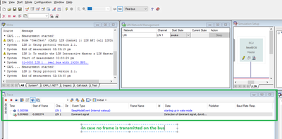

In the case of using the CANoe, we need setup a CANoe configuration as a master for the test. And then, they can trace all the frames that transmitted on the bus in the trace window.
To make it easy to understand, I have a example about CANoe configuration.
  1. In this case no frame is transmitted on the bus.

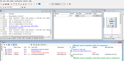

  1. In this case CANoe sends 2 headers(Break, Sync, PID) on the bus. And then the slave just sends the response with the header containing the PID as its publisher.

itsnewforme
How did you created the second condition where Master sends a header with no Response ?
Thanks in advance
Abhijit.
3,571 Views
DanNguyenDuy
Hi itsnewforme,
This is an example of CANoe's configuration(Attached) that has been used to test.
In this configuration, please see into CANoeTest.can. You can call UserSendheaderNoResponse() function to send a header with no response.
These is the frames that have been sent on the bus:
