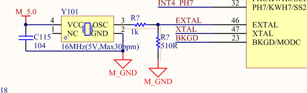

The MCU's clock circuit design as below:
the picture above is the Crystal circuit,
and the XCLKS pin not connect the pull-down,it is suspended;
the MODA and MODB connect the pull-down;

In troubleshooting the process described above, we found that there are two obvious deviations in the design:
1.The Crystal  output the 5V  square wave,Obviously exceed EXTAL maximum 2.16V input requirement;
2.XCLKS pin not pulled down;
Then make the following changes to the clock circuit of the MCU on the circuit board of the failed product (the MCU's PLL can not be locked occasionally):
At the same time the XCLKS foot drop pull, MODA, MODB and before, pick up the pull-down;
After the above circuit is modified, the MCU still can not lock the PLL; when the crystal oscillator outputs 5V square wave, the PLL can lock occasionally. After the above modification, basically no PLL lock occurs.

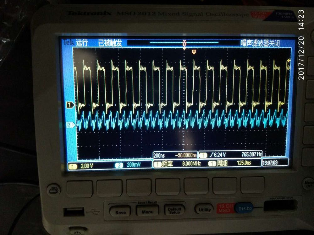

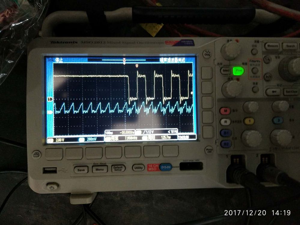

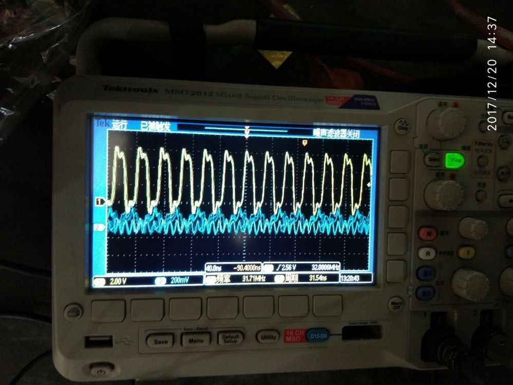

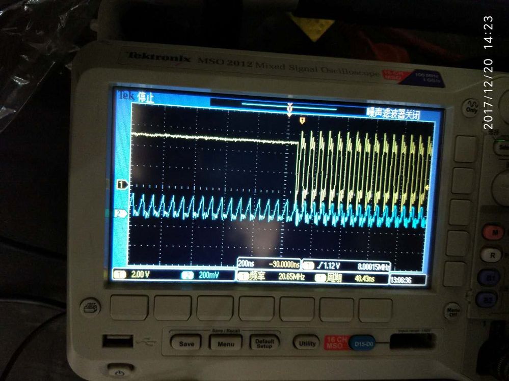

xiaochenqiang
Hi lama:
       Maybe the MCU's internal CLOCK circuit realy damaged;following is the scope of the test on the PE4 (the yellow scope),
the test phenomenon is: After the power on,the MCU can work normaly for some time,when it can work normaly,the yellow scope is the 5V High level,
and after some time(the time is random),the MCU can not work normaly,the scope changed from 5V high level to 5V square,and the square's frequency  not same every time;
       Can you explain why it occur this phenomenon ?
       when the PE4 become the square,it enter the internal clock mode?
       Thank you!
5,499 Views

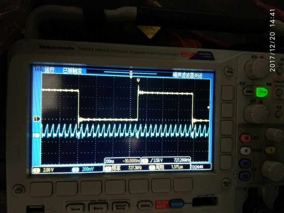

xiaochenqiang
Hi,based on  first picture circuit,I connect the MODC to the GDN,and then test the pin PE4,it is the OSCCLK/2,so the oscillator circuitry is not damaged?but some times, the MCU can not work normaly,because the PLL can not stable.why?
Below is the test scope:
the input clock is 16M,and the test scope is 8M,
5,499 Views
