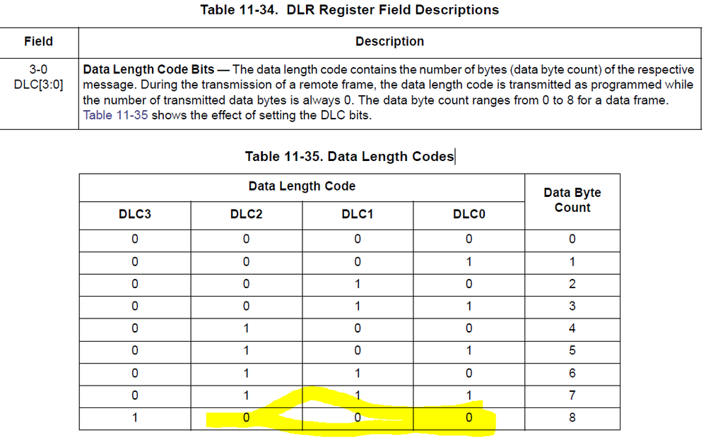

Max data length of a one message frame is DLR=8. Look at Table 11-35. Data Length Codes in the Reference manual.

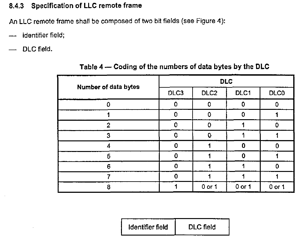

Generally,our messege length is 8,  but if we received message DLC field is 15(1111b),   S12MSCANV3 will stop wroking.
In the IS0-11898-1-2003,please see the following picture, if DLC field is 15(1111b), should be considered as 8.
But in our datasheet , there is no this definition when DLC is more than 8.
