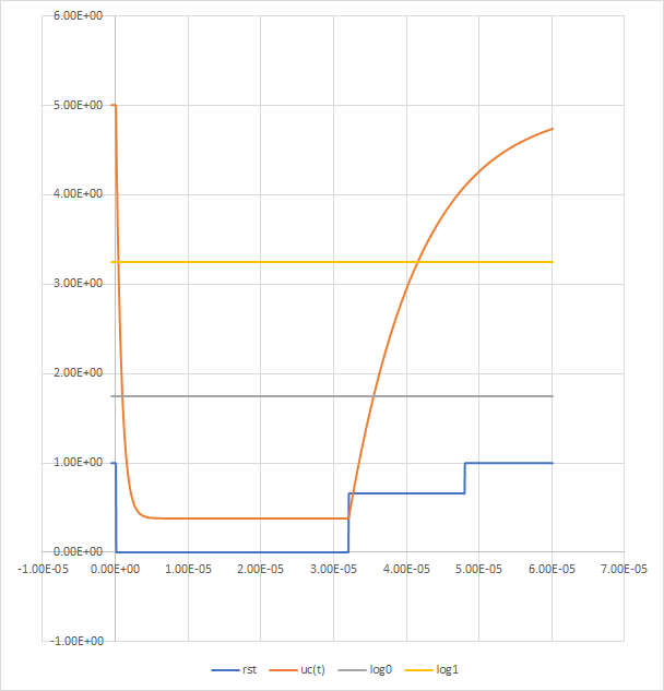

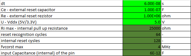

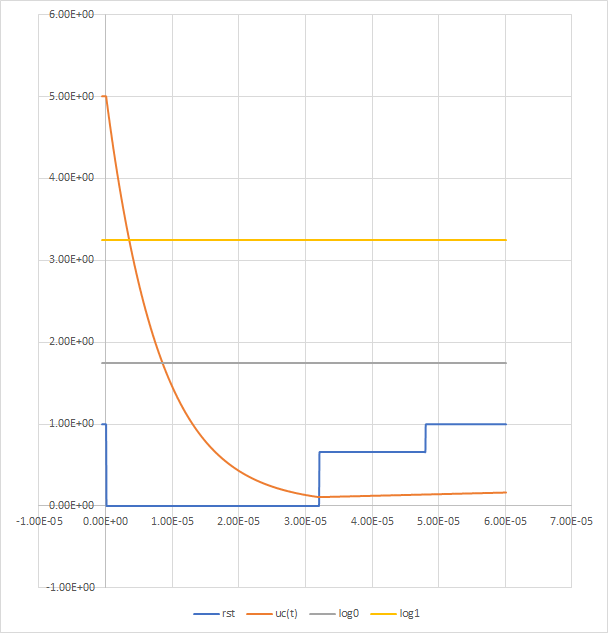

Just to add info just to increase complexity:
In the attached reset_recognition_calc_with_graph.xlsx  (file to calculate external reset, also can be used to investigate COP) you can see that if you use capacitor 100nF and only internal pull up resistor t the reset pin then you can be sure that when the COP is generate then after reset it is not recognized and the MCU starts at POR reset. (for this calculation worst case scenario of pull up resistor value is 25kohm)
The setup I described above:
Yellow and grey lines shows logic low and high
Blue line only shows reset timing phases:
- zero step when the rest pin is held low internally or externally
- the first step...COP recognition
- the second step POR recognition
Orange line shows voltage at reset pin
In the case you want to be able recognize COP then you should use internal pull up resistance worst case scenario 50kohm and you will see also an external pull up resistor will be necessary.
