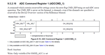

I want to know can we switch the ADC channel from internal to external OR vice-versa during runt time by updating the ADC command list?
In datasheet it is given that, ADCCMD register can be written only if SMOD_ACC bit is set
I am not using MCU special mode.
If we can switch the ADC channel from internal to external what precaution needs to take while implementing this switching in code.

Hi Pratibha,
Please have a look at Section 9.6.3.2.2 Introduction of the two Command Sequence Lists (CSLs) in the RM.
You can have two command lists and while one is active and should not be modified, the inactive one can be modified.
