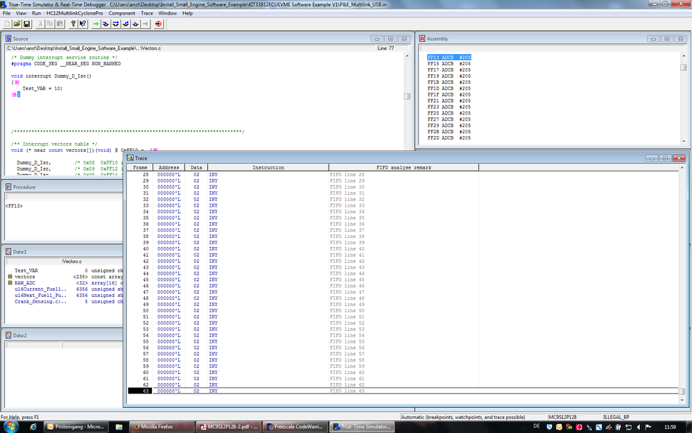

iggi
Looking at the PNG you attached, there is the Dummy ISR for interrupt vectors that aren't used by application but must be defined in case such interrupt happen so it can be serviced.
The PC holds the $FF13 value which should correspond to System Call Interrupt (SYS) (Vector base + 0x0012) which software interrupt. The SYS CALL interrupt routine should be called only when the SYS instruction is executed (opcode 0x18A7).
If you use CodeWarrior and its hiwave debugger, you can try the Trace component to find out the erroneous code:
Select in main menu in debugger: Component -> Open… -> Trace. New window will appear on the screen. Place a breakpoint into SYS CALL ISR, run the code and wait until breakpoint is reached. Then the set of asm instructions will be displayed in the Trace window. These are the instructions that has been executed prior the breakpoint, so you can find out what was wrong.

so i put all parts of the engine together and started the engine without the connection of the bdm cable and the engine is running :smileyhappy:
but now i always have the problem with the illegal_pb in the debugging mode. if i put a breakpoint in the dummy isr and start the engine, the code doesn't stopp there and anyway gives out the illegal_bp. I took some picture of the Trace windwos perhaps you know whats means the instruction INY.
