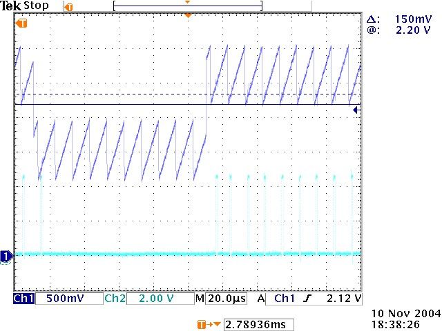

The IIC input voltage levels for the S912ZVLA microcontroller are not explicitly listed but they are typically defined by the digital input thresholds for the I/O pins used for SDA and SCL.
Typical IIC Pin Thresholds:
For 5V-tolerant I/O (which is common in the S12Z family), the input high voltage (VIH) is typically
0.65 × VDDx and the input low voltage (VIL) is 0.35 * VDDx.
If VDDx = 5V, then guarenteed value:
  • VIH>= 3.25V (minimum to be recognized as HIGH)
  • VIL <= 1.75V (maximum to be recognized as LOW)
Of course, real threshold value is somewhere between (1.75 + 125 mV) and ( 3.25 - 125 mV) considering 250mV hysteresis connected to this threshold for changes between log.0 and log.1
For example
Ladislav
For example
Ladislav
