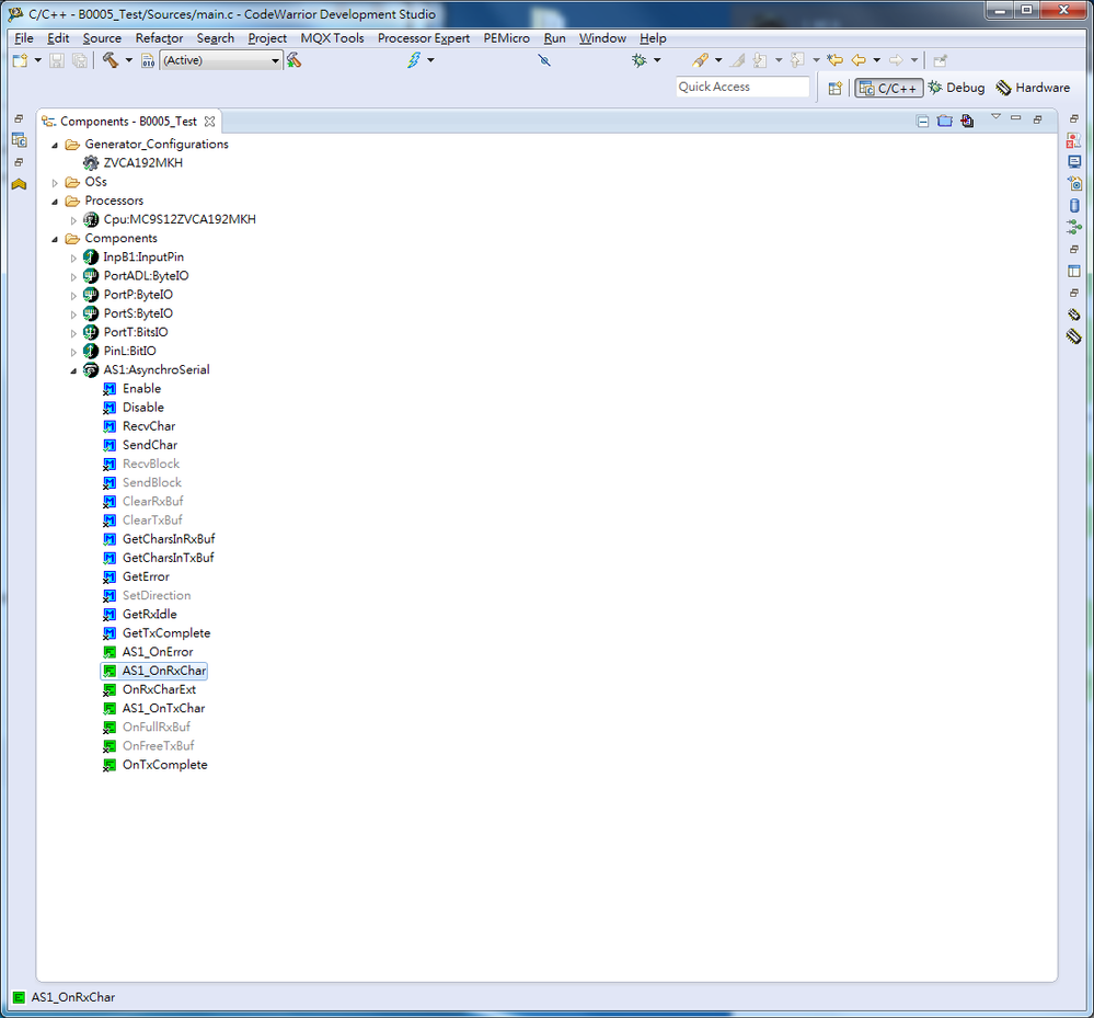

aaronlee
Contributor V
Hi Daniel,
I try to use Event of AS1_OnRxChar. It can work fine in DEBUG mode. But it can not work in NORMAL mode (remove MULTILINK then power off/on my board).
P.S. Main() code can work fine in both (DEBUG/NORMAL) mode.
void AS1_OnRxChar(void)
    AS1_TComData *ReceiveChar;
 /* Write your code here ... */
    AS1_RecvChar(ReceiveChar);
    switch(*ReceiveChar)
       case 'C':
          Pin_DO3 = 1; // LED4 OFF
          Pin_RCK_DoorLock = 0; // Door Lock (Lo Active)
          setReg8(DDRS, 0xF3U);
          break;
       case 'O':
          Pin_DO3 = 0;// LED4 ON
          Pin_RCK_DoorUnlock = 0; // Door Unlock (Lo Active)
          setReg8(DDRS, 0xF5U);
          break;
       default:
          setReg8(DDRS, 0xF1U);
          break;
   return;
4,386件の閲覧回数
aaronlee
Contributor V
My code as attachment
4,386件の閲覧回数
aaronlee
Contributor V
Hi, Daniel,
I resolved the issue. But, I don't know why.
The wrong code as follow:
The correct code as follow:
    AS1_TComData ReceiveChar;
    AS1_RecvChar(&ReceiveChar);
    switch(ReceiveChar)
Aaron
