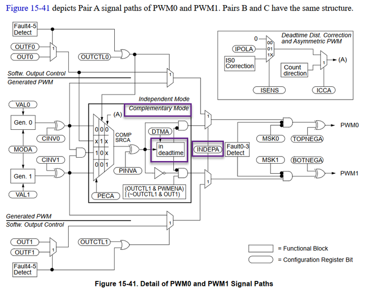

how to insert the dead time between HG and LG when the PWM of GDU is configured in independent mode, the datasheet mentions all the insertion in complementary mode.
Thanks!

Hi @yq1,
Unfortunately, the deadtime insertion is possible in the complementary mode only:
