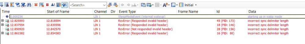

angang_hao
Hello Daniel Martynek,
I really appreciate you for your powerful support. Now I am very clear about what I need to do next. I will use the the sporadic to realize my requirement in code.
Thank you so much, my dear friend!
One more question about Lin communication.
Do you have any idea about how to change the value  of "sync break delimiter length"?
This is 1 bit length in my project now and when I connect 2 slaves, 1 master to the LIN bus line, an "incorrect  sync delimiter length" error will be reported. I think I need make it longer than 1 bit since as is told in LIN_specication_package2.2A, it is recommend using delimiter that is longer than one nominal bit-time.
Am I right about this error? and do you have any suggestion or comment about this error?

angang_hao
Yes, exactly. And acturally I found the rootcase of this issue which was caused by a unsuitable capacitance. After I changed it from 1nf to 220pf, this issue was solved.
Thank you for you feedback!
