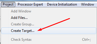

How could i build one project that have several targets?
I found one project in AN4258 which have so many targets. So i want  to build one project which have several targets, but i  can't found how to do it in cw5.1.
Anyway, does anybody have done this before? How to do it?

Hi tao,
In Project window go to Targets tab and mark default target
go to menu-Project-Create Target
enter new target name and select Empty target or Clone existing target (recommended)

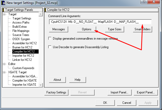

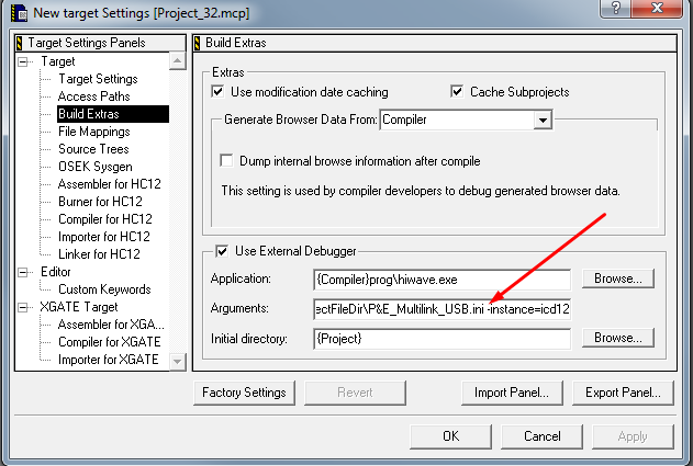

double click on new target name (Alt+F7) will open target settings and you could change for example debugger ini file
or compiler settings
Note: Targets are selected by clicking on icon.png icon on left side.
I hope it helps you.

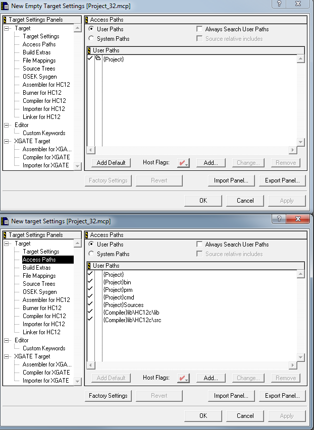

Hi, RadekS,
     I have created two new target in my project.
     The first one select Clone existing target ( it is the recommended), and this target works well.
     The second one select Empty target, then I copy all settings in standard to this new empty target.  Here is the problem, when i make for the second target, one error occurs.
Link Error: No file with extension prm found  in project.
     Now i don't understand is there any wrong in the second target? Are there any else settings what should i done?

RadekS
Hi tao,
I was able to replicate this error on my side.
It seems that you forgot update project paths:
When I added paths, project make was executed without errors.
RadekS
