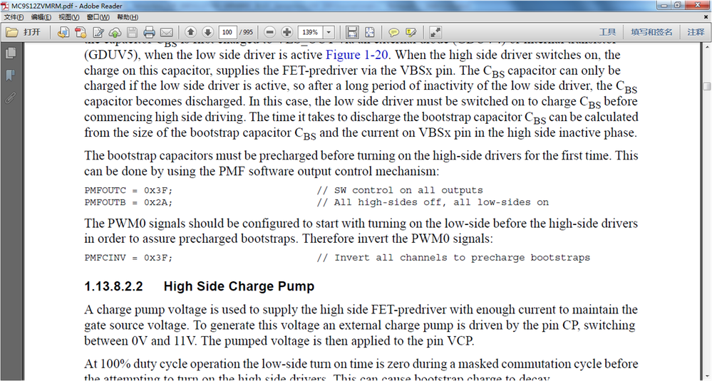

Hi, i'm using 9s12ZVML31, and the project uses the example project S12ZVML-MINIBRD_BLDC_Sensorless_CW_IDE. But now i found that hign side in the first period of commutation event can't be charged and opened because the PWM signals in the example project is congifured to start with high side before turning on the low side. So i read the reference manual as belows:
   I configure PMFCINV = 0x3F as the reference manial said,  the DCbus current and phase voltage should be re_configured, so how can i re_configure the PTU to measure the DCbus current and phase voltage.
