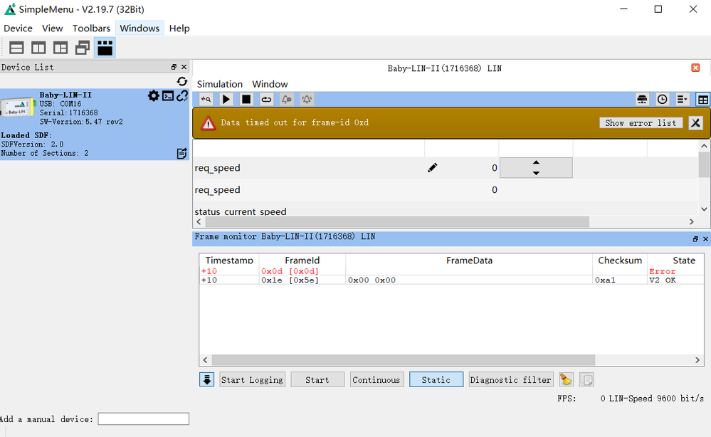

Hi Diana, Thanks for your support. I can build now.
Does this demo code work well based on S12ZVML-MINIBRD?  I tried a Baby-LIN-II to communicate with it. It failed.
https://www.nxp.com/docs/en/application-note-software/AN52LIN.PNG01SW.zip

Hi Peter,
I have not tested this SW with S12ZVML-MINIBRD, but the AN5201 SW is provided with the different boart S12ZVM128EVB. So, there can be differences in port usage.
In that case, I would like to recommend you start with the LINstack driver examples.
https://www.nxp.com/webapp/Download?colCode=FSL_LIN_2.X_DRIVER
Using NXP’s LIN Driver with the MagniV Family
https://www.nxp.com/docs/en/application-note/AN5122.pdf
For more details about S12ZVML-MINIBRD see:
S12ZVML-MINIBRD and S12ZVML-MINIKIT 3-phase Motor Control reference designs | NXP
I hope it helps.
Diana
