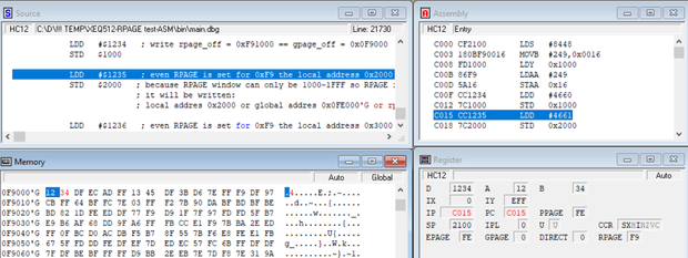

I am tring to understand how the CPU12 handles paging. We are using the MC9S12XEQ512.
When you have an instruction like LDY $1000, $1000 is located in paged RAM section of the memory map so I assumed that if RPAGE was set to F9 and you called LDY $1000, it would load the value at ram location 0xF9000.
If you want to access ram in page FA, I assumed the compiler would generate code to set RPAGE to FA and then also access the same memory area $1000.
However looking at my compiler output it still sets RPAGE to F9 and then accesses address $2000
LDY $2000
But according to the data sheet, $2000 is non-paged RAM (or ram at page 0xFE)
So I do not understand how this works. Can someone shine so light  on this for me?

I wrote a very simple program in assembly
LDAA #0F9H    ;get rpage value F9
STAA _RPAGE ;write to rpage
LDD #1234H
STD $1000
LDD #1235H
STD $2000
LDD #1236H
STD $3000
LDD #1237H
STD $4000
LDD #1238H
STD $5000
LDD #1239H
STD $6000
LDD #123AH
STD $7000
LDD #123BH
STD $8000
Accroding to your exel file, when I write to $2000 it shoud write to $0F_E000 but it actualey writes to $0F_A000

I do not know how you are reading and check the data. I suggest you to use either address 0xF91000'L or 0x0F9000'G to the debugger recognizes which memory space you want to access. The debugger does not considers memory window, you have to confirm it by 'G or 'L.
I have rewritten your code to the CodeWarrior asm project with comments and it is:
LDAA #$F9 ; write RPAGE = 0xF9
STAA RPAGE
LDD #$1234 ; write rpage_off = 0xF91000 == gpage_off = 0x0F9000
STD $1000

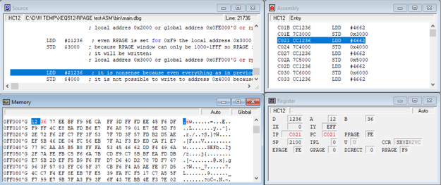

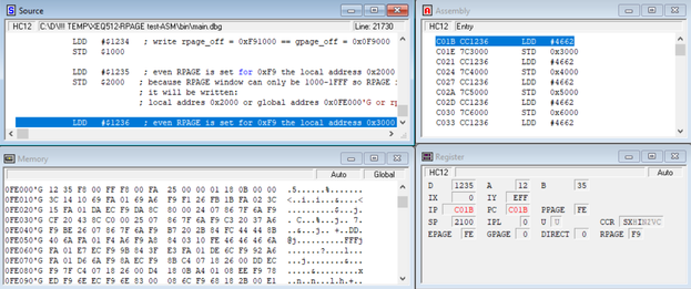

LDD #$1235 ; even RPAGE is set for 0xF9 the local address 0x2000 will be written
STD $2000 ; because RPAGE window can only be 1000-1FFF so RPAGE is not counted into access and
; it will be written:
; local addres 0x2000 or global addres 0x0FE000'G or rpage_off 0xFE1000
LDD #$1236 ; even RPAGE is set for 0xF9 the local address 0x3000 will be written
STD $3000 ; because RPAGE window can only be 1000-1FFF so RPAGE is not counted into access and
; local addres 0x3000 or global addres 0x0FF000'G or rpage_off 0xFF1000
LDD #$1236 ; it is nonsense because even everything as in previous case is valid but
STD $4000 ; it is not possible to write to address 0x4000 because it is nonpaged flash address space
STD $5000 ; it is not possible to write to address 0x5000 because it is nonpaged flash address space
STD $6000 ; it is not possible to write to address 0x6000 because it is nonpaged flash address space
STD $7000 ; it is not possible to write to address 0x7000 because it is nonpaged flash address space
LDD #$1236 ; it is nonsense because you are trying to write to a flash space given by address PPAGE_off
STD $8000 ; because you set offset from PPAGE paged window 8000-BFFF
The result for the first three working and correct approaches are here>
1)
2)
3)
It is necessary to think only on the last 16 bits and this value select the addressing mode whether it will be near 6 bit address only or it will be RPAGE used or PPAGE or EPAGE. I do not want to talk about GPAGE now. (GPAGE is used with as instructins GLD GLS)
I do not want but I suppose I will confuse you. There is one memory space with overlaps when you use short addressing mode with addresses 0x4000-0x7FFF. This address space can either address internal RAM or external bus or internal Flash. It is always necessary to think about global address space to understand the placement because it is linear and nothing overlaps. The address space 0x4000-0x7FFF is good to be think about if you want to access this RAM space – of course, if it is defined in the device, or if you have confusing existence and access in the case of phantom device.
I forget to mention. Some XEQ512 devices were made as a phantoms of XEP100 devices which has master set of peripherals and memory map. The phantom is created by simple definition of smaller memory map and less amount of peripherals or reduced features even it is the same device like “master” device. However, the phantom is not allowed to be used like a master device – loss of guarantee – the reason is that undefined peripherals o memory have limited tests so they do not have full guarantee.
I have attached the memory map of the master device. You can see it has also addresses 4000-5000 and 6000-7000 in the memory map of the RAM.
What is important is that the part 4000-7000 can be visible in the memory map as unpaged RAM or as a unpaged flash.
