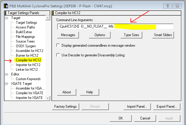

- we cannot read and write Flash from the same block at a time. Therefore during programming of a flash block, the command is usually executed from RAM (or other flash block if there is any)
- For the paged RAM, as it is written in .prm file - when using banked addressing for variable data, make sure to specify the option -D__FAR_DATA on the compiler command line (Alt+F7)

I already had to activate the compiler command -D__FAR_DATA because of start-up code related warnings.
However, this does not change the behavior (meaning that PPAGE is being changed instead of RPAGE when entering the RAM-function).
