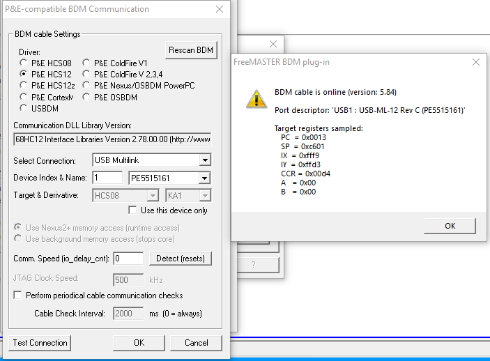

On Freemaster program I have set the communication  as shown in the file bdmConnection attached.

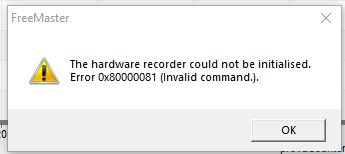

Now if I try the Recorder, Freemaster shows me the following message "the hardware recorder could not be initialised. Error 0x80000081 (Invalid Comman).

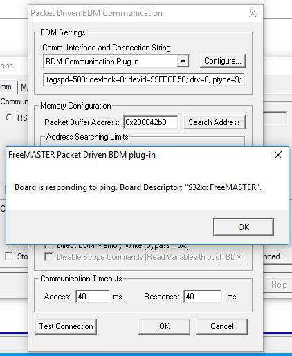

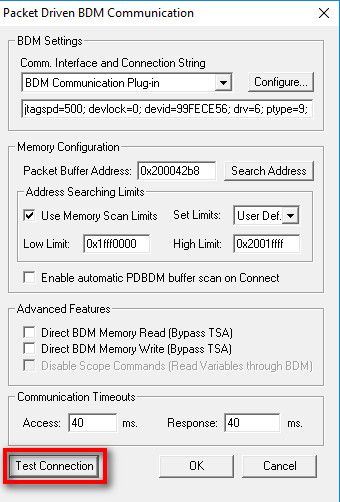

  I do not have any TOMAR (S12VR) EVB in my hand, but I have tryied on S32K148 EVB (the PacketDriven BDM communication principle is the same). Your setup seem to me be correct. After finding correct Packet Buffer Address (in my case for S32K148 device it is 0x0200042b8, in your project it is 0x3d12):
After pressing "Test Connection" button you should see following message:
Board Descriptor for my EVB is "S32xx FreeMASTER" in for your Tomar project you should see "HC(S)12(X) FreeMASTER" response.

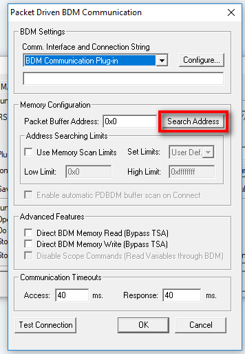

  Diana is right, if you would like use Recorder features using BDM communication you have to select Packet Driven BDM communication instead of pure BDM and configure it on PC side:
and configure it:
as well as on embedded side in the freemaster_cfg.h file:

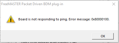

I have tried with your suggestion and I set Freemaster as following:
1) press Configure: choose HC12
2) Search Address (without check the box Usage memory scan...) -> find address 0x3d12
3) test Connection --> fail error 0x80000100
I have tried with test all configuration of this panel but the result is always the same.

With the recorder instead I have the following problem.
Best Regards
