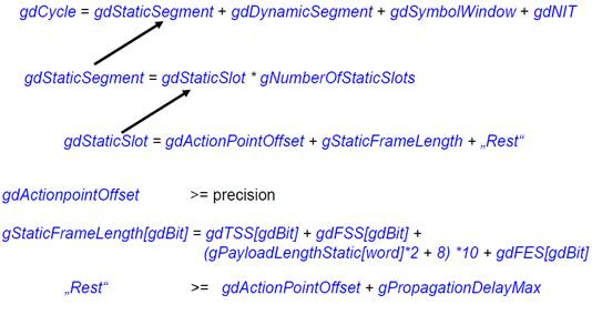

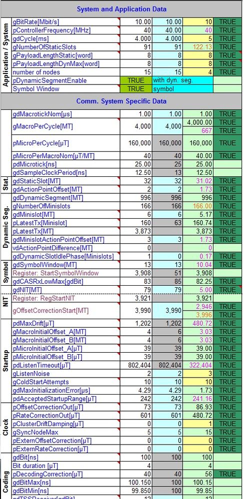

milanbaca
this equations have not been met
correct parameters are
4,181 Views
