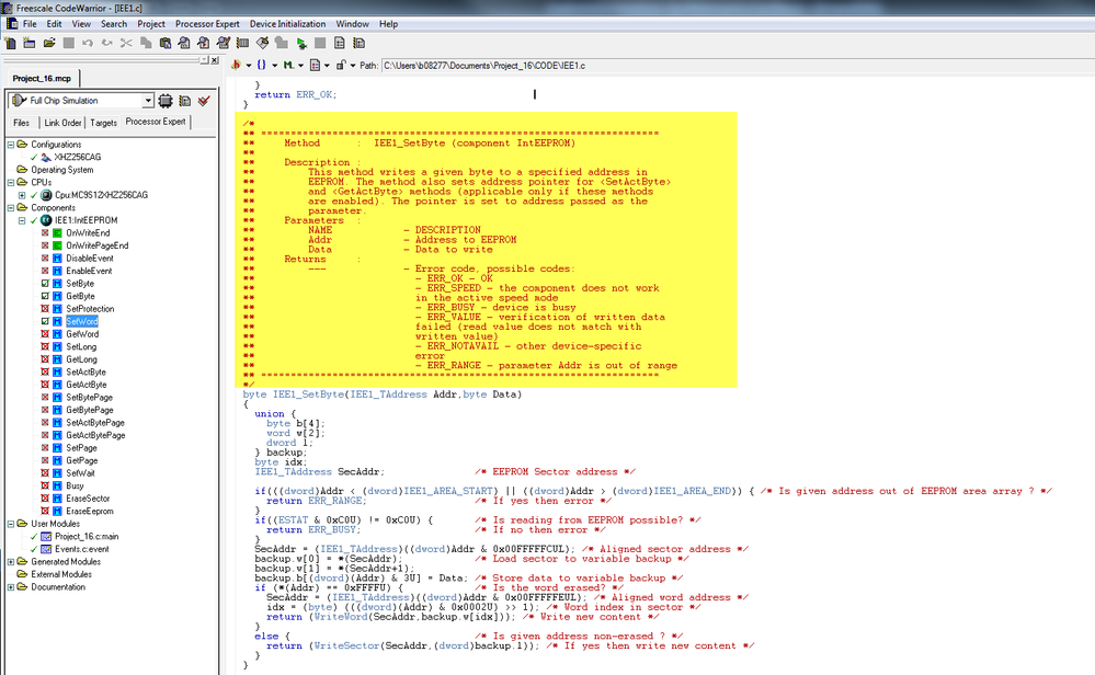

I am trying to use internal EEPROM in freescale microcontroller, what is difference between?
WriteWord(IEE1_TAddress AddrRow,word Data16)
WriteSector(IEE1_TAddress AddrSec,dword Data32)
IEE1_SetByte(IEE1_TAddress Addr,byte Data)
标签 (1)
标记 (1)
1 回复
883 次查看
ZhangJennie
Hi KDN,
are these three methods are internal, used by Processor Expert only.
WriteWord(IEE1_TAddress AddrRow,word Data16):  write the word data to EEPROM memory address <AddrRow>.
WriteSector(IEE1_TAddress AddrSec,dword Data32):  The method writes the data block to <AddrSec> allocated sector.
IEE1_SetByte(IEE1_TAddress Addr,byte Data): write a given byte to a specified address <Addr> in EEPROM.
for more information about these three methods, i suggest you check the comments in processor expert generated for them,
