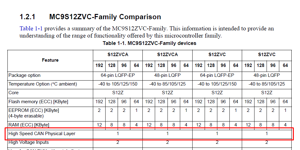

Yes, the S12ZVC family has a version with an on-chip CAN physical transceiver.
I'm not sure, what do you mean by 256 KB?
See image from the RM rev 2.1
