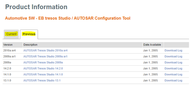

I found the MCAL package about S12XS, but it prompts an error in EB tresos 26.2.0, such as "No license for module Adc_TS_T11D7M4I3R0_0"; I think this is caused by the incompatible version of EB, but I can't find it on the NXP official website The EB link corresponding to S12XS, and the page about AUTOSAR 3.0 on the NXP web page includes EB tresos, such as https://www.nxp.com/design/automotive-software-and-tools/autosar/autosar-3- 0-x-classic-platform-software:AUTOSAR-3, here mentions "Includes 3rd party AUTOSAR configuration tool (EB tresos Studio)"

Hello BigHello,
You can access this website to download the EB Tresos:
https://nxp.flexnetoperations.com/control/frse/product?child_plneID=710907&ver=ARC
You must read the "Release note" of the driver to know the version EB Tresos used.
You can select "Current" or "Previous" to find the version of EB Tresos, that you want to download.
Dan
