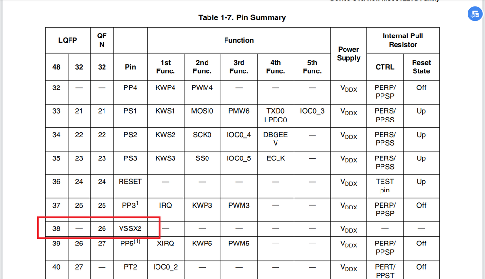

Does PP5 can output high in S9ZVL32MLC?
spec:VSSX need available,what's mean?

the mask set of the32 and 48 pin device is the same so vssx2 has no influence on output function of the pin.

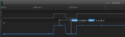

jingfang
32pin has 2 kinds of package.
FM 32QFN PP5 is ok;
LC 32LQFP :
IC TypeEngineer AEngineer B
Mark
S9S12ZVL32MLCcan output highcan't output high/PWMEngineer B did the experment today.
S9S12ZVL32CLCcan't output high
The voltage measured by a multimeter is 0.9V
PP3 can output high ,PP3 jumper to pp5 line, LED can be nomally lit (note the perpheral loop is OK)but the pin is very hot.
So I suspect 32LQFP does not have VSSX2,PP3/PP5 output will damage the pin.
I don't know if that's right?

jingfang
On the client's board, PP5  can't be set as high.
Is there anything I can try?

lama
If you go through datasheet with the keyword PP5 search results, I believe you will understand, that it says about current possibilities of the pin PP5. Similar condition is related to also other pins. Some of the devices do not contain VSSX2 pin which limits the current load flowing from outside to the MCU via PP5. If you use exceeded current to the pin then the electromigration can cause destroying of the supply wires. (ticking time bomb)
Yes, PP5 can also be used as output pin with current possibilities given by data sheet. The current (+)/(-) means flowing to/out_of the pin.
As you can see PP5 can supply(-) in output mode only -10mA load (current flows from MCU to the load). PP7 is able to supply in output mode -20mA. The PP5 is more immune for current flowing to the MCU (+) if the MCU contains also VSSX2 pin.
