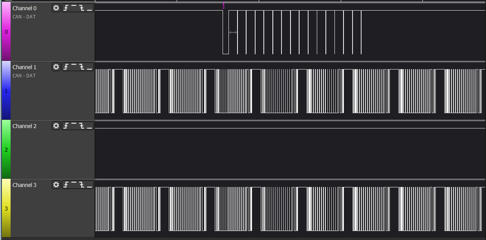

I've got a problem with the CAN bus, I've configured the MSCAN0 with code warrior expert (bit rate: 250 kbit). The system works fine in loop back mode: I can send data and the event CAN1_OnFullRxBuffer() is called, tha masks also work fine. I've got a problem when I want to use the CANPHY with CANH and CANL pins of the board: the CANH pin is stucked at high voltage! :smileysad:
I configured the CANPHY in this way:
CP0CR_CPE = 1; //Module Enable
CP0CR_SPE = 1; //Split Enable
and the M0C0RR[2:0] to 000
Did i miss something in the configuration of the CANPHY?
I've also tried to probe the data between CANPHY and MSCAN0 with the M0C0RR[2:0] configuration 0b100, in order to use the pins TXCAN0 and CPRXD0 as probes.
Channel 0: MSCAN0 TXCAN
Channel 1: MSCAN0 RXCAN
Channel 2: CANPHY0 CANH
Channel 3: CANPHY0 CANL
The RX data is coming from a PCAN simulator, if  the simulator is stopped no data is present on channel1 and channel 3.
Thanks for your help!

I think I found the issue!
I have a problem with processor expert generation, cause I've downloaded an example that is not generated with the expert and with these libraries and seem to work fine:

There is a way to generate a functional CAN example with processor expert?
Cause I've generated the rest of my code with processor expert... :smileysad:
thanks!
1,992 Views
dianabatrlova
Unfortunately, there is no CAN example with Processor Expert.
I recommend you to look at AN4975 https://www.nxp.com/docs/en/application-note/AN4975.pdf
By PLL_init() function you configured the clock frequency but you can also configure it by processor expert.
