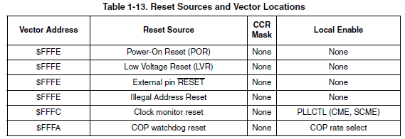

3. Reset sources are described in Table 1-13. Reset Sources and Vector Locations in RM.

Really it is little bit confusing about the resets. If i take the example of cop watch dog reset if it times out reset will happen then why there is separate interrupt address for COP watchdog reset that is $FFFA why not it is $FFFE. In case if i do not add any function is cop watchdog reset isr. what will happen? Or is the sequence is like first goes to the address $FFFA then goes to $FFFE. please help. Similarly for clock monitor reset and illegal address reset.
