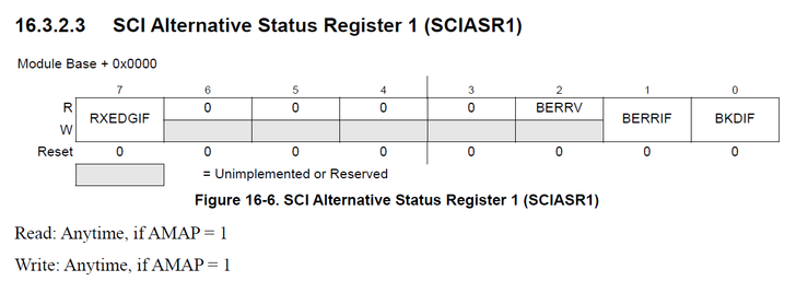

        I follow your idea to test my mcu.when the mcu was awakened,I deliberately delayed 5ms and 2s to send the data.I find when I send the first and second frame, the mcu was no response until the third frame.I test many times. The result is the same.Can you help me examine my follow program. I guess I read the SCIxSR1 and SCIxASR1 value,that mean I have cleared the SCI flag. Delay 5ms and 2s,I think  clock of the mcu shuld have reseted successfully.
void lin_hal_ISR(void)
l_u8 sci_reg_sr1;
l_u8 sci_reg_asr1;
sci_reg_sr1 = LIN_SCI_REG->SCIxSR1; /*lint !e923*/ /* HW register access */
sci_reg_asr1 = LIN_SCI_REG->SCIxASR1; /*lint !e923*/ /* HW register access */
lin_hal_rx_data_guc = LIN_SCI_REG->SCIxDRL; /*lint !e923*/ /* HW register access */
//LIN_SCI_REG->SCIxASR1&=0xFF;
//LIN_SCI_REG->SCIxSR1=0xFF;
1,464件の閲覧回数
danielmartynek
Hi @sunkemiao2021,
Hard to say what could be wrong, it requires debugging on your side.
But in the code you posted, there is one issue.
The SCIASR1 register can be read if AMAP = 1.
