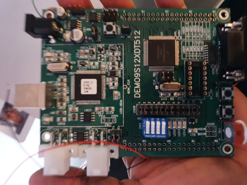

Hi Everybody,
I have DEMO9S12xDT512, I configure CAN0 and everything is OK
I took the same setting and try to configure CAN1 but its does not work.
CAN1 RX/Tx is in PM2/PM3 which can also be CAN0 or SPI.
I don't see in the datasheet if we should configure something to incidate that its CAN1 which should be used?
I saw
The CAN1 function (TXCAN1 and RXCAN1) takes precedence over the routed CAN0, the routed SPI0 and the
general purpose I/O function if the CAN1 module is enabled.
Can someone help me please?
Thank you in advance

mwendzao_oussei
Hello Daniel Thank you Very much
Is the number you asked is in the picture I sent?
If not I can found the package
Thanks again

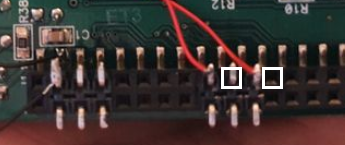

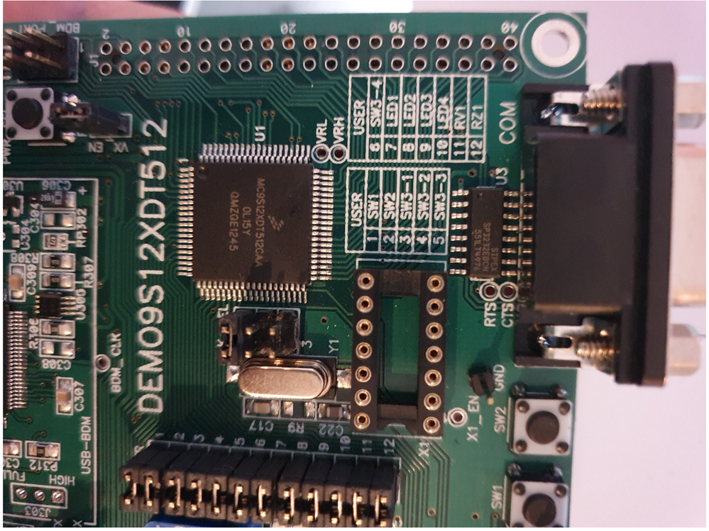

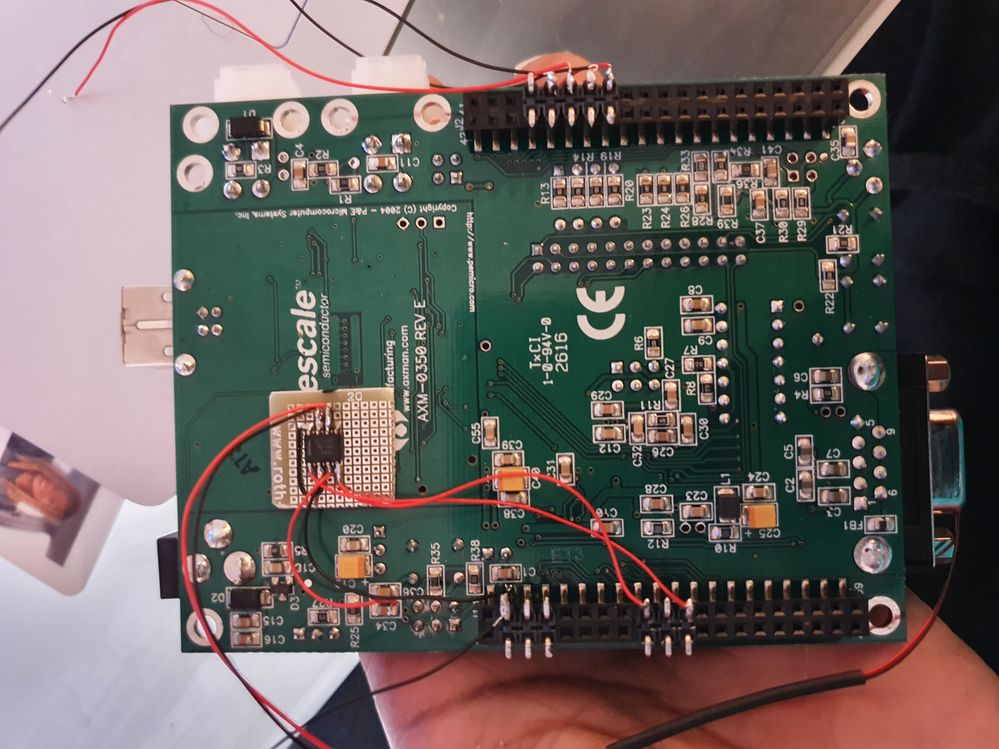

3,921件の閲覧回数
danielmartynek
Hi Mwen,
Thank you for the mask number.
I tested it on the same board (the same MCU, mask 0L15Y) with the code attached.
There is no CAN transceiver on the board connected to PM2, PM3 so I just pulled CAN1_RX to VDD and scoped CAN1_TX.
The CAN1 module is clearly routed to the PM2, PM3 pins and it works as expected.
As you sure you connected the transceiver to the correct pins?
