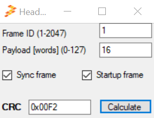

I just want to know how decimal 242 is computed for header CRC? The header section could be as follows:
1. 0x00090 ; //frame ID =1, payload length=16, all other bits = 0
OR
2. 0xC0090 ; // in addition to above, synce frame and startup bits = 1
I tried using the usual CRC techniques (Ex-Or), but could not match decimal 242.
Requesting a little more of your time, dianabatrlova‌, RadekS‌.

dianabatrlova
Hi Rohit,
I have found a very useful application to calculate CRC. see the attachment.
I believe it helps you.
Diana
4,313 Views
ramakr02
Thank you Diana, the application was exactly what i was looking for.
Best,
Rohit
