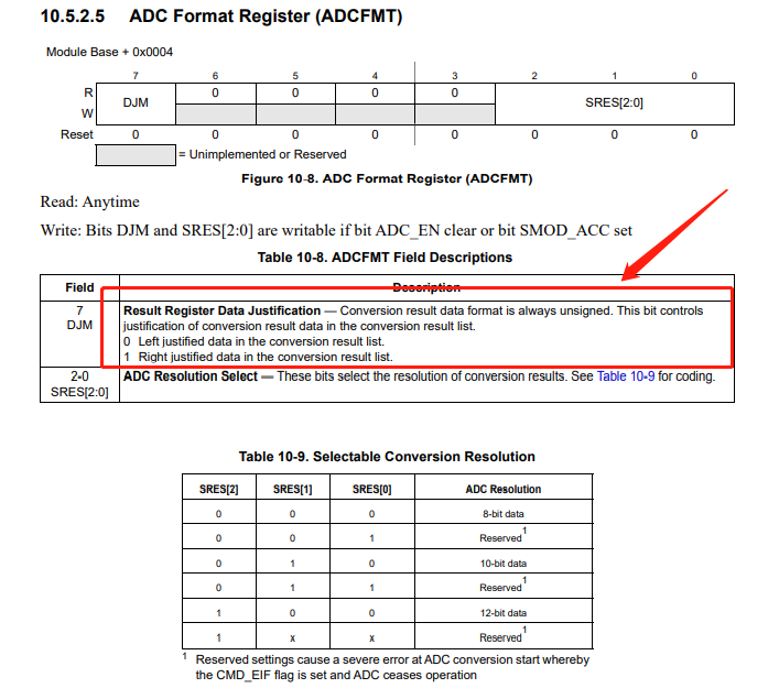

DJM: Result Register Data Justification — Conversion result data format is always unsigned. This bit controls justification of conversion result data in the conversion result list.
Q: I want to detect the negative voltage in the circuit, but according to the data manual, the conversion result is always unsigned. How can I detect the negative voltage with sign?

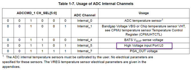

I have some other question:  Can I measure more than 9 volts or 16v?
1,615 Views
danielmartynek
Yes, it is, using HVI (High Voltage Inputs).
Please refer to the S12ZVL RM.
2.4.5 High-Voltage Input
J.1 High-Voltage Inputs (HVI) Electrical Characteristics.

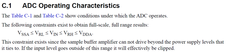

danielmartynek
Hi @Jen1,
The ADC can't measure negative voltage.
The input voltage (V_IN) must be within the <V_RL; V_RH> range.
If negative voltage (V_IN < VSSA) is applied to a pin, the voltage is clamped to VSS.
Please refer to the S12ZVL RM,
C.1.1.4 Current Injection.
A.1.2 Current Injection
Table A-10. 5V I/O Characteristics (Junction Temperature From –40C To +175C)
