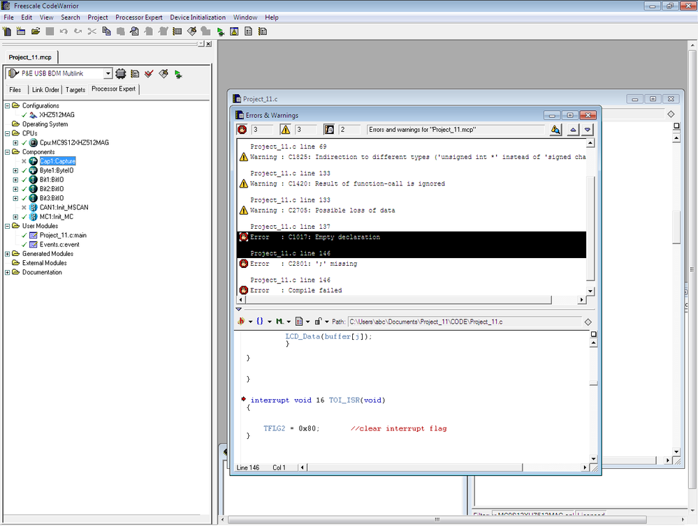

I am getting this error

This code is not working for input capture mode
#pragma CODE_SEG __NEAR_SEG NON_BANKED
interrupt void  IC0_ISR(void)
  //  new_capture = TC0;   //save the value of input capture register
    LCD_Cmd(0x80);
              PORTA = 0xFF;
         t[i]=TC0;
          i++;
          if(i==2) {
          i=0;
       //    6.0742270546073012209196379760675e-8
         time_interval=(t[1]-t[0]);
         time_period=(float)(0.0000256* time_interval);
         frequency= 1/time_period;
         sprintf(buffer,"%f",frequency);
         for(j=0;j<4;j++)
         LCD_Data(buffer[j]);
   TFLG1 = 0x01;       //clear interrupt flag
interrupt void  TOI_ISR(void)
    TFLG2 = 0x80;       //clear interrupt flag
unsigned int TM;
/* User includes (#include below this line is not maintained by Processor Expert) */
void main(void)
  /* Write your local variable definition here */
  /*** Processor Expert internal initialization. DON'T REMOVE THIS CODE!!! ***/
  PE_low_level_init();
  /*** End of Processor Expert internal initialization.                    ***/
  /* Write your code here */
        LCDIni();
//   LCD_Cmd(0x01);
   LCD_Cmd(0x80);
   LCD_Data('T');
    PPST_PPST0 = 0;  //set pull-up
    PERT_PERT0 = 1;  //enable pull-up
   TSCR1 = 0xE7;       //enable timer, stop timer during wait and freeze, disable fast flag clear
   TIOS_IOS0 = 0;      //channel 0 as an input capture
    TCTL4 = 0x01;       //capture on rising edge
    TIE_C0I = 0x01;        //enable interrupt on channel 1
    TSCR2 = 0x80;       //timer overflow interrupt enable, timer prescaler is 0
  for(;;){}
  /*** Processor Expert end of main routine. DON'T WRITE CODE BELOW!!! ***/
  /*** Processor Expert end of main routine. DON'T MODIFY THIS CODE!!! ***/
} /*** End of main routine. DO NOT MODIFY THIS TEXT!!! ***/
