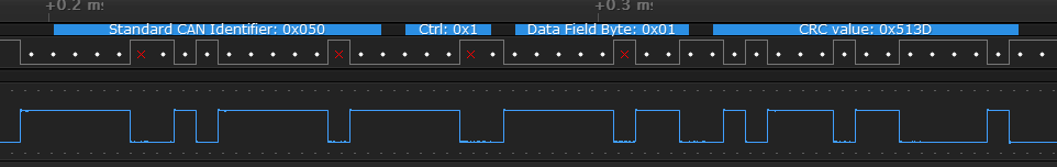

I have bought two DEVKIT-S12XE development boards. Quick start package also download from web side.
Connect two boards as document 'DEVKIT-S12XE Lab Examples and Board Overview', page 6. Download the software in folder 'Lav4_CAN_S12XE ' into one board, and simulate in the other board.
Can bus can't be connected successfully between two boards.

I have downloaded the example code without any modification into DEVKIT S12XE (we have only one board) and measured:
TXCAN0 (PT17)
and the on CAN_H/L (both open)
  /* Creation of CAN frame */
  id = 0x50;                         /*  Message id               */
  data_send = 0x01;           /*  Data to be send        */
  SendFrame_CAN(id,&data_send, 1);
In idle state, you should have a recessive level 2,5V on both CAN_H/L.
Are you sure there is no short on the boards after your soldering?

zoejiang
Thank you for your reply.
Hard ware engineer and I tried it again. And we found TP13( port 5V-3)  is always 0V during software running. We checked the signal of SPI set in soft ware.  But we still have no idea.
Can you give me an e-mail about the software you tried?
Or give me some information about how to make TP13 5V?

I use the example code from DEVKIT-S12XE page.
DEVKIT-S12XE Quick Start Package/…/LAB4_CAN_S12XE
Is the System Basis Chip MCZ33903 supplied (PT2 = 12V)?
Have you tried running only one board as I did?
Does it mean that you have the same problem on both boards?

Hardware engineer and I finally find we used the wrong power.
Now the problem is solved.

You can power the S12XE MCU via the USB (5V). But you need 12V (VBAT, J9, J8, J12) for MCZ33903CD (SBC) which contains CAN, LIN transceivers and power regulators. In this case, you can supply the S12XE (VDD) from P5V0_SBC (J13).

I meet the same problem, i solder short R94,  connect jumper j13.2 and j13.3
CANH/LOW is 0V,
TP2 is 5V
TP13 is 0V
only user power supply J9 is 5V.
follow you I need to push12V in J9?

I known problem. I need to connect 12V connect with J9. Then problem is solved.
