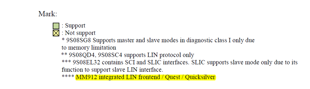

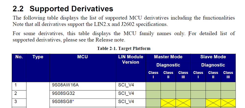

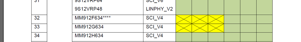

    I have another question.  According to the LIN_User_Manual introduced, the MM912F634 can not  support Master mode, which confuse me. What is the difference between Master device and Slaver device?

    I am sorry that I didn't find the link to LIN_User_manual.
    I installed FSL_LIN_2.X_STACK. The LIN_User_Manual stored in the "'Documentation" folder.
    This is the screenshot from the LIN_User_Manual.

danielmartynek
Thanks for the part number.
Unfortunately, the master mode hasn't been tested on the device.
Do you want to use the device as LIN master?
3,427 Views
guofeng
   I want to test the LIN. But I only have two KIT912F634EVME.
   I was curious that why the KIT912F634EVME can be slave, can not be master.
