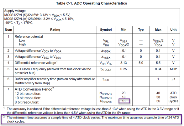

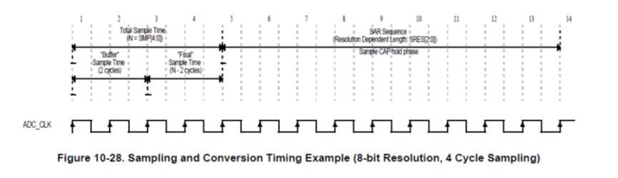

the above figure as the example ,8-bit data,4 cycle sampling , the adc min sampling time=?
the adc sampling time =adc clock/12 or 13? if is 13,why?

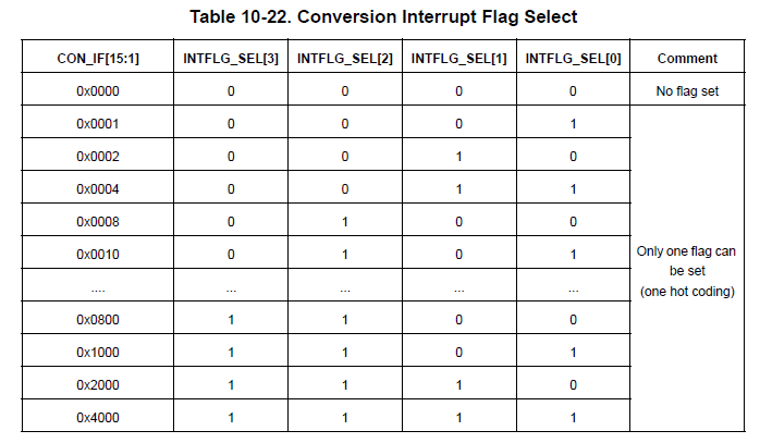

The INTFLG[3:0] is to configure the interrupt flag number(1~15),the interrupt flag number is defined by myself? If I want to sample the AN3,can I set the interrupe flag number is 1 or 2,...?

The ATD conversion time is specified in Table C-1, S12ZVL RM rev2.48
In the Figure 28-10 example:
Sample time: 4 ATD clock cycles
Hold time: 12 ATD clock cycles
Conversion time: 16 ATD clock cycles.

Please see the description of the ADC command registers in the RM.
In ADCCMD_1[CH_SEL[5:0]] you can select AN3.
In ADCCMD_0[INTFLG_SEL[3:0]] you can select which interrupt flag is set in the ADCIFH/L register
at the end of this conversion.
