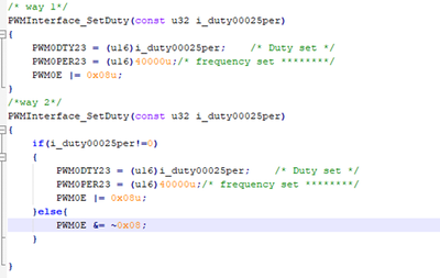

Hello everyone,
While using s12zvl to output PWM, the PWM duty output can be set to 0 in following two ways:
Way 1: The value of the PWM0DTY23 register is set to 0, That is, set the duty ratio register to 0 without disable the PWM output.
Way 2: The value of the PWM0E register is set to 0, That is, disable PWM output.
Both Ways can control PWM off, but when PWM is started (duty: 2%), it is found that the duty of the first PWM cycle is incorrect in the case of way1, The cycle of PWM in the first cycle of way2 is correct.
I want to know the difference between the two ways。

Hi @Xuqq,
What does it mean the PWM is incorrect?
Can you show some waveforms?
If the channel stays enabled, the duty register is buffered - that would be the difference.
You can write 0x00 to the counter to sychronize it.
BR, Daniel

It is explained in the RM shown below, basically, it allows changing the duty-cycle at the end of the period (typical use case) not at the time the register is written.
The polarity bit is set to 1, right?
Since it is double-buffered, and the last value is 0, it does not go down in the first cycle.
You need to synchronize it by writing 0 to the counter.
BR, Daniel

Thanks for your help. The polarity bit is set to 1. Writing 0 to the counter register can solve this problem.
Write a non-zero value to the duty register. After closing the PWM output, there is no problem to restart the waveform. However, write 0 to the duty register. After closing the PWM output, if you do not write 0 to the counter register, there will be a problem.
Is it a special operation to write 0 to the duty register?
Is the asynchronization of the counter register due to the random disable the PWM output? Are there other reasons?
