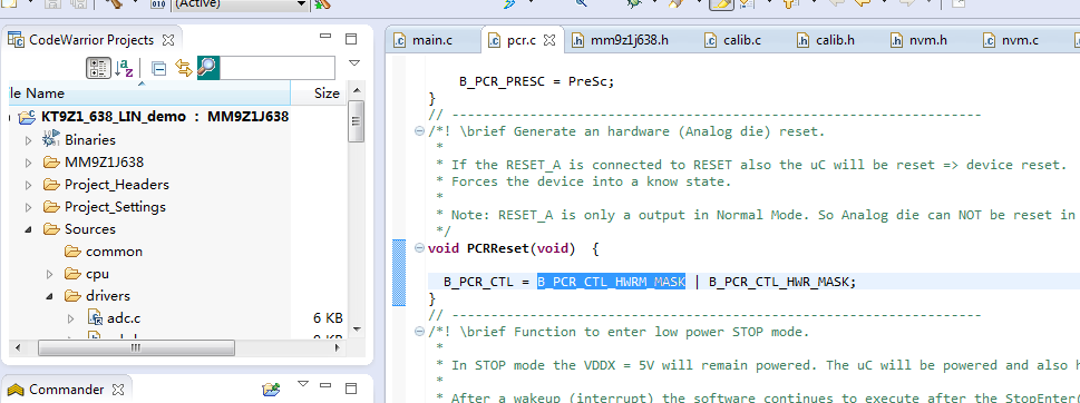

Hi all,

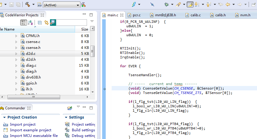

Firstly,I use the demo which the NXP supplied,I can't acquire the current,voltage and temperature

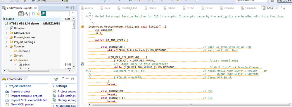

then it come interrupt.......
could you tell me why ?
thank you
Dawei

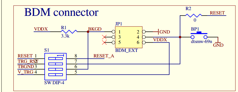

Hi Dawei,
Could you please clarify exactly which board you use?
Please check whether you have connected RESET_A and RESET pins.
If yes, please disconnect it during debugging in the special mode.
I hope it helps you.
Radek
1,389件の閲覧回数
dws
Hi Radek Sestak,
I don't connect  Reset and Reset_A, I used OSBDM to debug the board
1,389件の閲覧回数
dws
Hi  Radek Sestak,
I used KIT9Z1638EVM board.
Looking forward you replication!
thank you !
Dawei

Hi Dawei,
I am sorry for my late response.
Thank you for more details.
I tested KT9Z1_638_LIN_demo software with similar results.
Per documentation: “after 5s off no LIN communication the device enters low power mode (LED D4 off)”.
When MCU is in low power mode, also D7 LED is turned off. Unfortunately, the MCU cannot be debugged in low power mode since there missing clocks.
So, I suppose that you testing KT9Z1_638_LIN_demo software without LIN master node.
If you testing KT9Z1_638_LIN_demo software with LIN master node, there might be some issue in LIN communication settings.
If no LIN master is used I recommend to use the SCI based demo, which allows to run the application and monitor the measured signals on a terminal as described in the documentation.
Regarding LIN demo and entering low power mode….
The LIN driver just provides information about the LIN no bus activity. The main.c does check this and enter low power mode…
So just ignore / comment out the following code will do the job.
