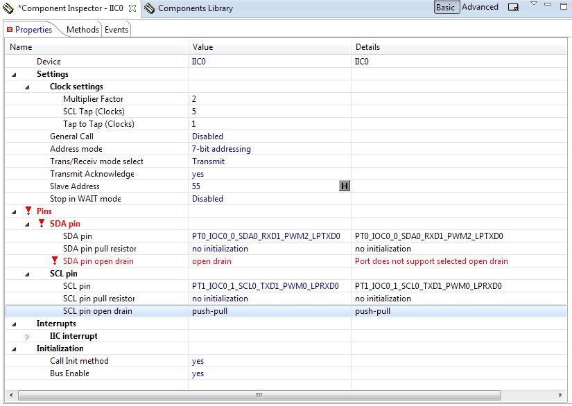

huang_hw
Thanks Radek for the clarification. Now I can confidentally use these two "second function" pins for IIC.
I assume I can ignore the "Bug" in Code Warrior->Component Inspector IIC0's PIN configurations.
I was earlier unsure because the IIC configuration in my Code Warrior Component Inspector for the IIC module has Pin configuration for the SDA and SCL pins that are set to "SDA/SCL pin open drain" = push-pull and it gives an error message of "Port does not support selected open drain" when I try to set it to open-drain.
(See image below where I tried to set the SDA pin to open-drain)
2,834 Views
RadekS
Hi hw,
Thank you for screenshot.
It really looks like error in PE configuration.
Anyway, this settings is probably related to pin configuration prior we enable IIC module.
When we enable IIC module, module will overtake driving of these pins despite on previous GPIO settings (except routing).
I will report this issue..
Thank you.
2,834 Views
huang_hw
