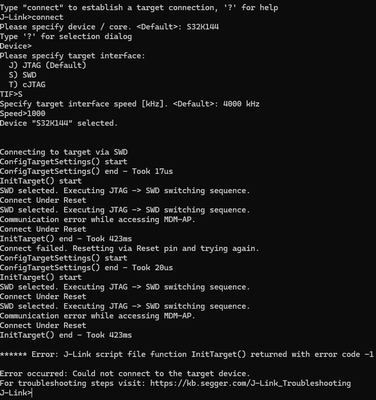

7,360 次查看
xete
I am trying to flash firmware on to the BMS.
However, I am facing this error when attempting to connect via SWD.
7,356 次查看
cisvmierlo
Hi @xete ,
Could you explain more about your setup in which you face an issue?
How did you power the RDDRONE-BMS772?
What is the status of the RGB LED on the RDDRONE-BMS772?
A picture of your setup would be helpful to be able to assist you in your problem with programming.

7,290 次查看
xete
Hi @cisvmierlo ,
Thank you for the quick reply.
I was powering the BMS with a 4S battery. I was also using 3.3V TTL to USB to look at the serial output. The BMS was in the NORMAL state based on the LCD Screen and Serial.
It was connected to a J Link Compact Plus according to the pinout below.
Do let me know if you require any other info/suggestions for troubleshooting
7,284 次查看
cisvmierlo
Hi @xete ,
It seems that the IC is powered and working.
A 4S battery (both LiPo or LiFePO4)  is indeed in the correct supply range. That cannot be the issue.
Maybe a full disconnect (battery, programmer, serial interface) could help?
It could be a connection issue.
Can you try a slower programming speed?
Long wires and pin converters could impact the maximum programing speed.
You now use 1000kHz, "1000", can you try "100"? 100kHz programming speed?
If you would be able to upload a picture of the setup, that might show an issue.
Or provide the voltages on these programmer pins.
It would be interesting to know if the MCU is kept in reset or what VTref is.

6,126 次查看
xete
HI @cisvmierlo ,
Thank you for your help. Lowering the clock speed solved the issue.
