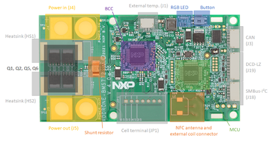

Please ask questions about the RDDRONE-BMS772 board and software here
