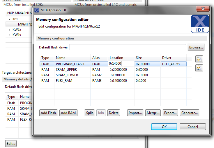

I am unclear on how to move the K64 Firm Ware to 0x14000. Sounds like it has to do with the MCUXpresso linker. Would you mind sharing on what the settings must be to do this? This would be very helpful.

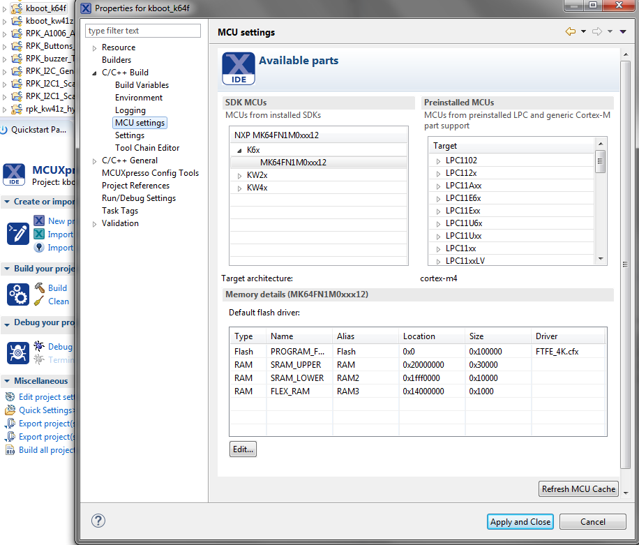

  • Right click on the project and follow the menu down to; C/C++ Build>MCU Settings.
Here are the settings for the boot loader: Flash location is 0X0, which is correct for boot loader
Now with a from scratch project, you need to change memory manually (To do so, click on the Edit button, right below the memory table)
In project generated from the studio, this is taken care for you, no need to change the address.
