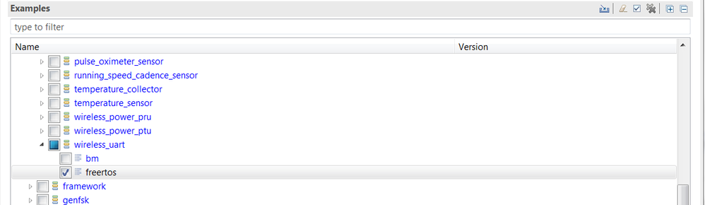

The first step to Import "wireless uart" project from KW41z SDK examples.

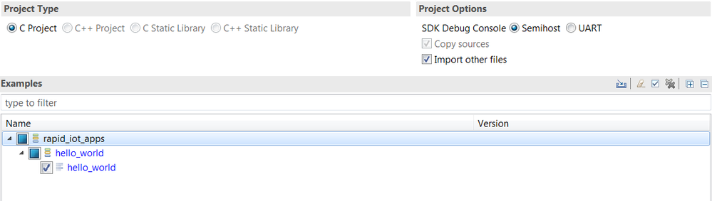

The next part is Import the "Hello World" example from Rapid IoT Kit SDK

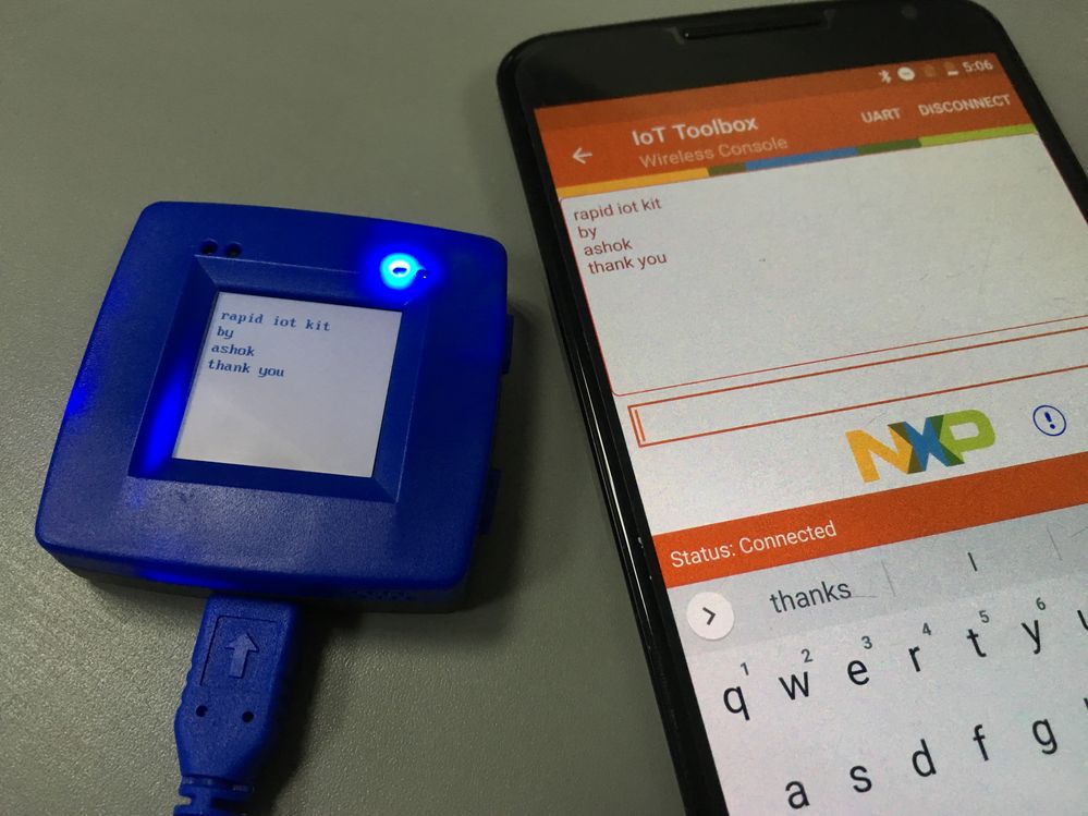

Compile the code then flash it into Rapid Kit, and  the demo is ready!
Happy Coding!
Working demo of video is here Rapid IoT Kit - Wireless Uart Demo
