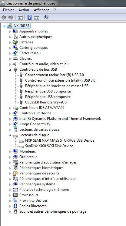

gaubuali01
Yes I did try in Windows and there were no new device plug in. Even there wasn't Windows USB plug in notification sound.
I think there is a hardware problem. The kit can be powered from USB port but there is no communication.

Eric_Ma
For now I have no hypothesis on the problem origin. Sorry to ask even more questions:
Once the kit is in Mass Storage Deivce (MSD) mode (pressing , can you take a snapshot of the device manager, expanding the USB controllers section and the Disk drives sections ?
Should look like below:
If you have any warning or exclamatino sign, that would mean a driver issue.
If nothing abnormal is reported I owuld feel stuck for the moment, cause I do not have an idea yet what else to try.
