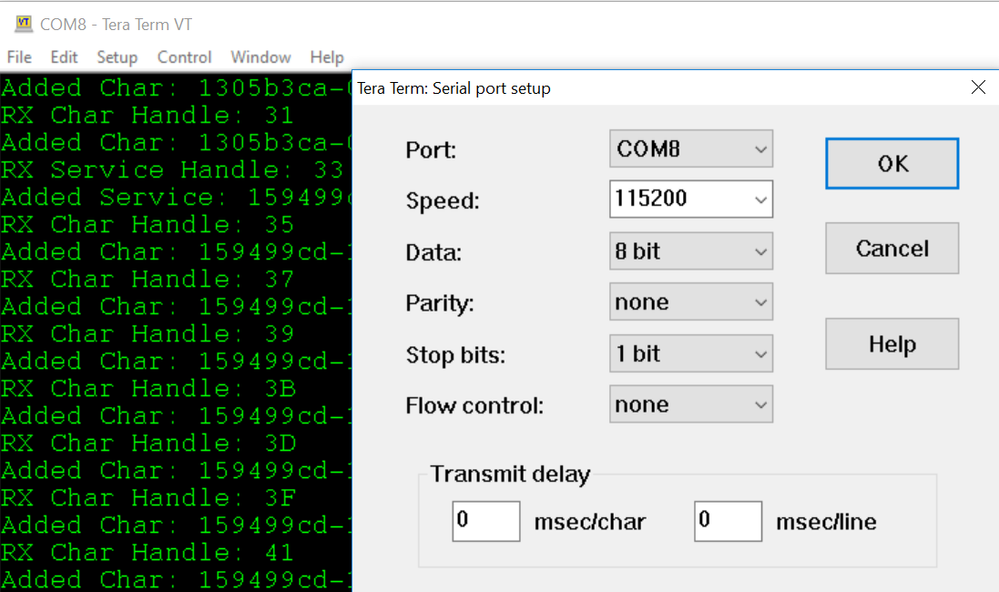

There is a log of events available when plugging the kit to a PC via USB and opening a console (Teraterm for example).
==> Could you record a log for a simple application (Led over BLE) that you would generate, flash and try provisioning?
As indicated,  make sure the accounts used for studio and mobile are same - I expect it was already the case, but just in case...
Using Teraterm, restore set-up from .ini attached to capture log or:

I  started Tera Term, in NXP studio i compiled the Control LED with app over BLE Demo firmware example and downloaded it, droped it in my device, tried to provision it but that never ended so no further activity in the log at the end.

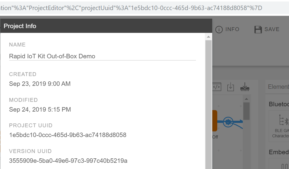

As you can see in your log, something wrong happens around the project UUID:
Stored Build UUID: 5c3348ce-f766-4d53-990f-847d9e56f630
Current Build UUID: 634b22ce-b332-41dc-a1bError opening file ota_complete
Uuid Match 0 Boot After OTA: 0
Wiping Flash
Those 2 should match - I cannot explain yet why it is not the case on your device. Now this is what is preventing you from provisionning. To help me further putting a diagnosis on what is going wrong exactly, could you check for that very same project which is 'the correct' ID by checking project info in the studio ? (Or reading the http addess completely?)

I see it in the working Rapid IoT Kit Out Of Box Demo (Deployed) firmware log.
In the studio i did open and compiled the project again, dropped it in my device while recording the attached LOG
The project info belongs to this LOG.
See Appendix,
Greetings, Hans
