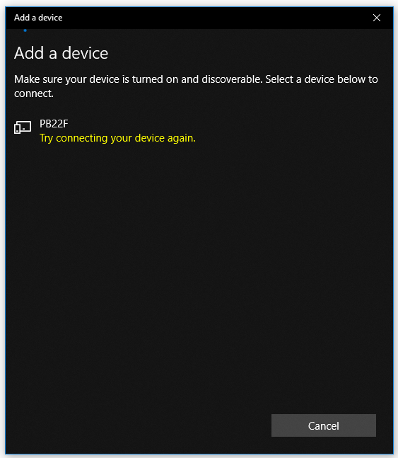

Hi to everyone !!
I wrote this question because I have a problem. I wish to pair a NXP rapid IoT with a Windows operating system.
When I go to the Bluetooth & other devices -> Add Bluetooth or other devices -> on Add device panel I am able to "see" the NXP rapid IoT, but when I tray to connect I receive the following error: "Try connecting your device again".
Any ideas or information?
Thanks very much !

mdobrea
Yes I'm using Rapid IoT Kit Out Of Box Demo. The windows (Version 1803 - OS Build 17134.590) detect the device (Rapid IoT) see below - B22F are the last characters of the number printed on the back of the case. But when I want to connect, each time I get this error:
I imagine that the problem is related to the Bluetooth communication parameters. So in the studio I change the BLEConnection block parameters to "Custom Passkey" and "Just Works" (in PAIRING TYPE field) - Random Passkey it was initially. I got the same error.
Are there other places to change the Bluetooth communication parameters ? Or do you have other solutions ?
Thanks a lot !
              Dobrea Dan.
