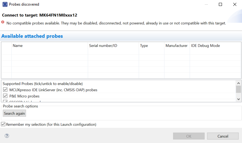

I had the Rapid-IOT kit connected to the laptop via the USB cable. And I was trying to launch the debug session of a Rapid-IOT program in MCUExpresso. However, I was getting the following message saying that no compatible probes available.
What would be the problems here? I looked at the User Guide and it mentioned something about the Docking station shipped by MikroElektronika. Is the docking station necessary for debugging in MCUExpresso?

It is necessary to have the docking station in order to debug.

Alternatively, you can use J-Link EDU Mini debugger with the rapid-iot adapter board. You don't have to have a docking station to debug.
